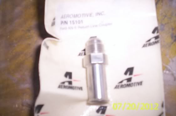

Lemeon that is not the fitting. I need the other side to that fitting. That fitting pictured is used to replace stock lines with AN but still using the stock rails. I want to do the opposite.
I need a female spring lock to AN fitting. Where do i find it?

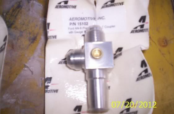

I need something exactly like this but without the T.
Just a straight fitting. -8an

To clarify, are you attempting to use the stock polished hard lines that go up the block to the stock fuel rails? I just converted to 1/2" rails. The only way I'm aware of is to use the fittings shown earlier at the frame rail and run braided or pushlock to the fittings in the new rails.
Could have misread somewhere.
