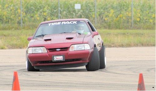

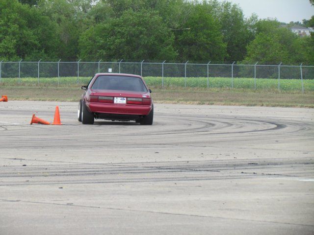

#25 · (Edited)
Hope I’m not hijacking the thread but I’ve been following this and it looks like there is some good discussion on F/R balance, body roll etc. Below is a pic of my car at an auto-x this past season. To me there appears to be an excessive amount of body roll; I also have what I’d describe as steady state understeer. I’m thinking a better combination of swaybars is needed but I’m not sure where to go with it. I’ve have a pretty good selection of OEM and aftermarket front bars to choose from. Current car set up is as follows:
Front:
MM kmember, std. offset fox length arms, 425# coilovers, mm race 2 struts, 15/16” swaybar, 16x11.5x23.5 hoosier slicks, -2.25* camber, 1/16" toe out per side.
The control arms are set in the bottom holes.
Rear:
MM TA/phb, MM 7/8”x.125 rear bar (set 1 notch from full soft), 325# coilovers, mm race 2 shocks, road race lower arms, 16x11.5x23.5 hoosier slicks, T-lok w/ carbon fiber clutches, 3.55 gears
The engine is a mild HCI (about 275/310 to the wheels). My minimum weight per CP rules is 3,020 and I usually come in right there; F/R weight distribution is 56/44.
I’d also like to know the merits of going to sn95 std. offset or forward offset A-arms relative to front end grip.
#26 ·
Your current setup has about 57% of the roll stiffness coming from the front suspension. This is low considering your front weight bias is 56%. Normally this would make the car loose, but since your car doesn't have enough overall roll stiffness for the grip, you are loosing quite a bit of front tire grip from poor camber angles up front.
I ran some simulations on your car. I think the best thing to do would be to install the stock 1.30" front swaybar with a 1.25" x 0.120 wall rear bar. This will increase the overall roll stiffness by 55%. The front roll stiffness percentage will be adjustable from 62.9% to 67.3%. With the improved front camber angles this will make the car more neutral.
We don't sell a 1.25" x 0.120" rear bar, but I made one for a customer a while ago. I think they are no longer using it. If you are interested in it, PM me. You would still need to purchase the arm kit for the 1.25" bar. MMRSB-95
I would change the swaybars before doing the FCAs. You will get a much bigger improvement for the dollar.
