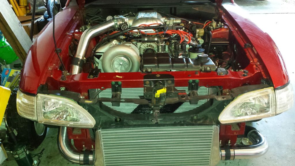

Thought i'd post some pics of the installs I've done with both style intercoolers. I found the cx racing 3" core I/c way to restrictive so I swapped to a Treadstone! Can't wait to get it dyno tuned again. I custom made the piping up from the cx racing piping which is really nice piping by the way.
First off the Cx core- was able to retain most of my bumper support with this one. Didn't touch ps lines either they still sit in stock place for both cores.
Now on to the Treadstone core which is MUCH MUCH bigger-
Had to cut the whole center of the bumper support out to make this one fit-
Mounting brackets in the bumper support-
All done- Pretty easy over all to install these.
I should have went with the Treadstone core from the start. You definitely get what you pay for!
Hope this helps anyone!

The treadstone looks nice, however comparing a smaller 3 inch CX core to a 4.5 TS is not really a fair comparison. My bet is the CX 4" core would not be far off from the TS.

Mainly just an installation thread with these two. Can't really compare them except treadstone is much higher quality all the way around

Everything else aside, the cores themselves are about the same quality. Just one is thicker than the other. I can tell you from experience, they are ok for the money, but not great by any means. They are both Ebay cores that are likely sourced from China cheap.
I am curious to see what gains made by the thicker core though. Esp now with summer coming along. I still had such a problem wit IAT's with these cores
