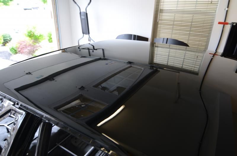

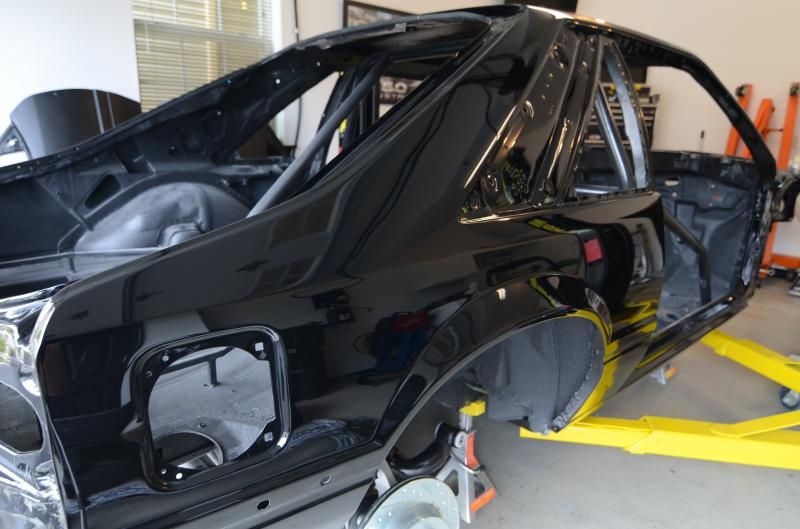

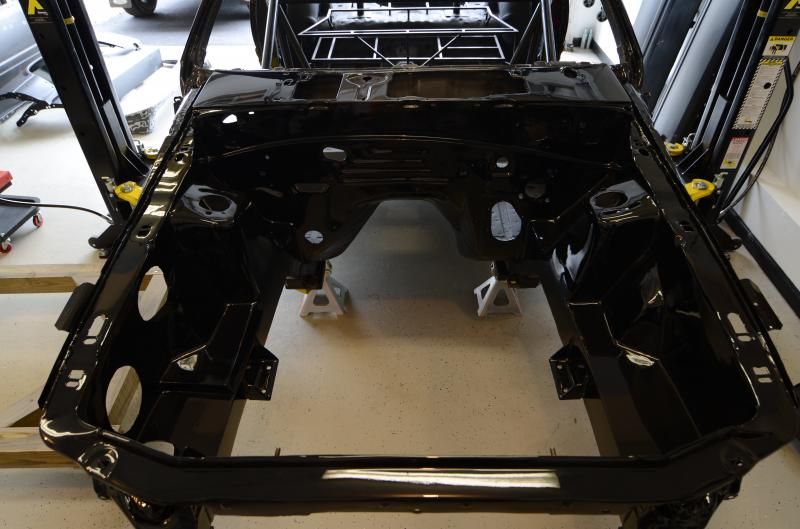

I just got my shell back from the painter a few weeks ago. All dents were removed and the car was completely blocked straight. I chose PPG concept single stage. Three coats with more clear progressively added to the color. Followed by wet sanding and then 4 stages of buffing/glazing. The engine bay and door frames were not rubbed out. I could not be happier. I'm $2,500 into the paint job at the moment. I plan to be below the $6,000 mark when it's all said and done.
The guys above are right. They more you can do yourself in terms of disassembly and reassembly, the more you will save. Most shops won't spray over an unknown product, so if you are attempting your own body work, consult the shop first. When I did the filler and primer in my engine bay, I bought the products directly from the painter. This way, he is spraying over product that he knows will work well together. Also, find a shop that is passionate about what they do and is proud of their work. A shop that treats your car as their own is a shop worth paying for.
