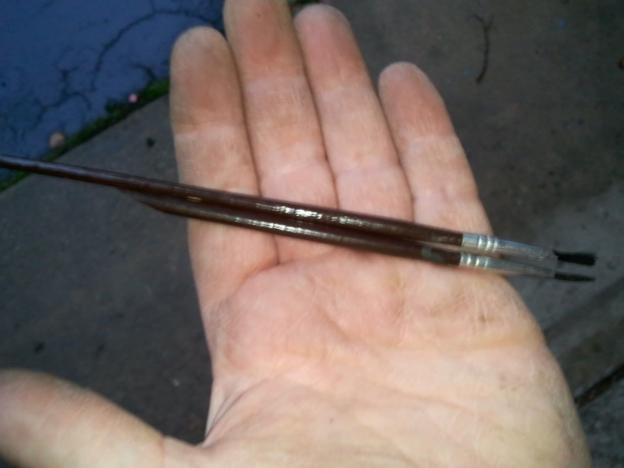

After putting a new TFI module on i was getting TDC before timing car. I was turning crank with ratchet in other hand i was holding small wood #2 touch up brush to verify piston at top, right as it reached TDC i must of held brush on angle not sure how the F--- it happen i hear snap and pull out snapped brush. Piece is 1 1/4 long and under and 1/8 thick. Ive been vacuuming hole and tried putting rolloed up elec. tape in so far i have not seen or felt piece any ideas? i would appreciate thanks
this is snapped brush and full one next to it for example

8950HO what that is me holding the brush that lost a peice in my engine and another unbroken brush of same size to show the difference how much is in motor. I had to lift and turn dizzy to get to back bolt holding TFI when i did this i forgot to note rotor direction thats why i was getting TDC and then going to time motor.
