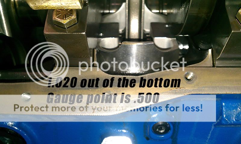

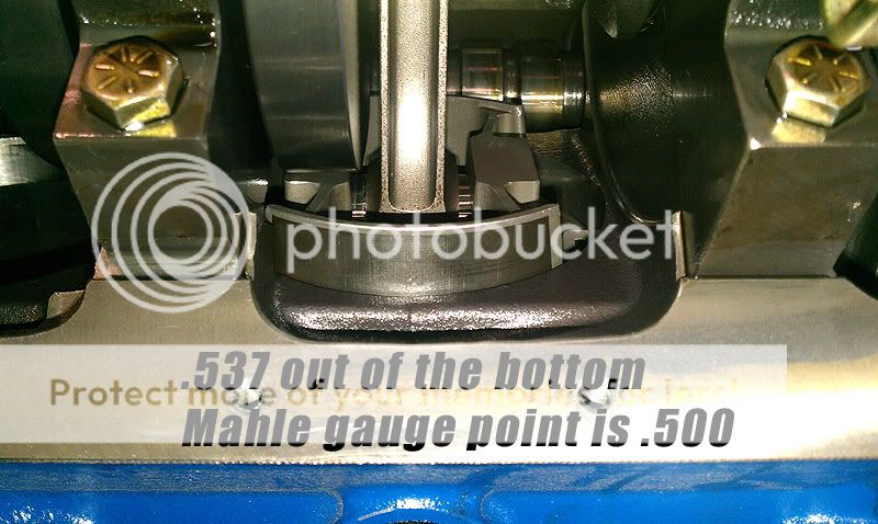

Boss302 Block, which is an FRPP block not an old Boss block has shorter piston skirts. Where a stock block has a support casting hanging out below the bore, the Boss 302 block cuts them off. If the fit point is too low on the piston, you will have problems for sure.
These photos are from Fordstrokers.com
Here is the piston that is claimed to be used in the FRPP crate 347 (4.03x3.40) using that block

The piston sleeve in the Boss block is shorter then the in the stock block. The bottom of the Piston moves out of the sleeve. According to Ford Racing this is not a problem - it is.
Hopefully somebody with experience can explain that better - I'm only trying to repeat what I'm told.

I believe the term for this is not piston slap such as in a cold forged piston before it expands due to heat but actually piston rocking when the whole piston actually "slants" in the bore.

I agree with the it being piston selection/skirt length ... even in the pictures they were different pistons ... I am no guru on these but I do think if you run the proper skirt length the piston slap issue would be less of a worry ... I think if you went to 331 stroker kit it would be even less with appropriate length skirts/pistons and maybe that is where the success stories are coming from. I agree the Dart is superior in design due to its multiple abilities and combinations on rotating assemblies ... but I don't think the Boss is junk either ... just needs a more specific set up when being stroked. I do like the idea of sleeving the block to achieve the desired length (Costly on top of block and machining) but should make for a really stout foundation as well. Nonetheless good thread ... and this is just my .02
