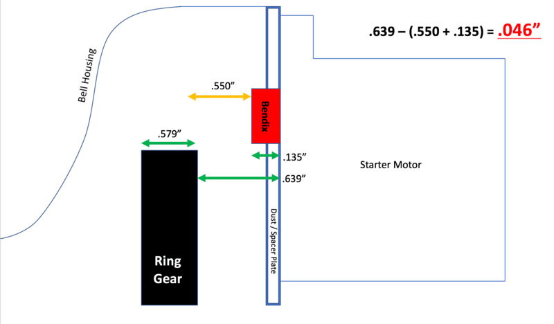

I am at the point where the car is ready to be fired after a year and half build and the god damn starter is being a P.I.T.A
I had a very similar problem on the last 351w I had in the car. Ground out a flywheel until there wasn't enough teeth left to start at all.
I have done hours of thread cruising and have yet to find a solid answer.
So I turn the key, and the motor spins basically freely. You can hear the pinion gear it hitting the flywheel. OCCASIONALLY, the motor will engage enough for me to see the belt move maybe 1". After trying 20 times I said no way is this right and pulled the to measure all the mating parts of the assembly.
[/URL]
I determined there is only .046" of engagement between the starter pinion gear and the ring gear on the fly wheel. On a ring gear that is .550" thick that is unacceptable.
The one useful bit of info a found was some starter motors for the 351w had a 2" Snout while others had a 2.375" snout. Even with the .2375 that only gets me half engagement which i'm not thrilled about.
Does anyone have any experience with what the heck I am dealing with? I bought the starter motor form Bond Auto and asked for a "97 Ford F250, 5.8l, Starter motor". Is there a starter that anyone knows about to remedy this issue?
Thank ya!

UPDATE:
So I compared starter motors and sure enough, I have the "Short" version and the long version looked MUCH more like what I needed (shown below). I have all the plugs out of the heads (as I am checking for spark at the moment) so there is hardly any load on the starter.
Engages the flywheel perfectly and spins smooth. You can see the nice .380" of engagement in the picture below. No grinding or chewing anymore.
