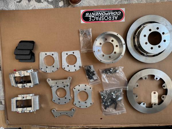

#19 ·
#22 ·
I have an opportunity to buy a complete 8.8 rear axle from a 1995 Mustang that has all the disk brake components attached. I don't need the rear axle, but I would like to get the brake parts, and it's cheap enough to buy it all and still be ahead money wise.
Can SN95 rear brake parts be installed on an 8.8 with Fox length axles? I understand the mounting bracket may need to be modified. Or maybe they can be bought?
Are there SN brake calipers the same as the 93 Cobra stuff? Will they fit inside 15 inch Drag Comp wheels?
The car is still 4 lug, and will stay that way. Switching to 5 lug is not an option. Does anyone sell rotors that are compatible? Could I drill the rotors to be 4 lug like LMR and Foxbody Brakes?
I realize the brake conversions have been discussed ad nauseum, but I can't seem to find answers to all of my questions.
for sn caliper and rotor axle length is different I started down your path and come to the conclusion to just switch to five lug I dont beleve 95 axles will work
