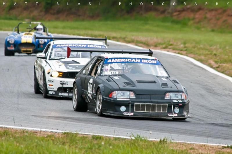

Run the longer lower control arms on the rear, ala World Challenge Arms. And a SLA up front. By widening the front track you can get nice geometry with longer upper/lower control arms. When I raced a fox in AI I made all my stuff, I had a 74.5" track width up front, 74" in the rear. I think my lower control arms were around 29" but it's been a while. I ran a DIY 3 link though. BTW, I used 2" rear wheel spacers on each side with no problems.
