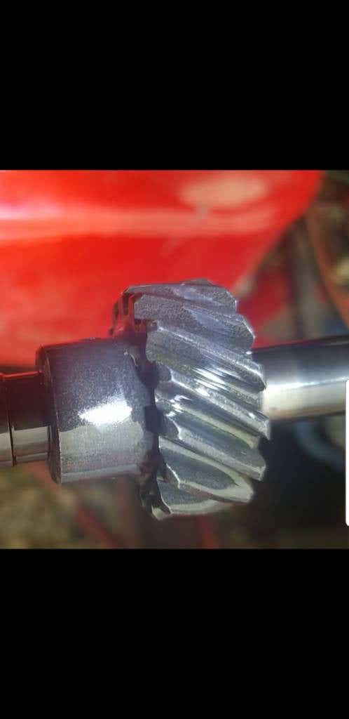

Hi need your help guys. I have an msd pro billet distributor and my gear keeps wearing too quickly. I just replaced the gear and let it break in for 15 minutes and there is already wear. I'll attach a pic of the gear I just installed and the gear before that. I have a Edelbrock rollin thunder cam. I called Edelbrock and they told me to use a melanized iron gear. I have an oem replacement oil pump as well. What can I test to figure this out? Any tips or help is greatly appreciated

Alright guys so I measure the depth and the machine shop did not set it at the correct depth. I'm gonna punch out the pin, set the depth and do myself. Hopefully this fixes the problem. I'll let you guys know.
Sent from my SM-G955U using Tapatalk
Pattern does seem to indicate in needs to be that 0.050" deeper. That's pretty far off.

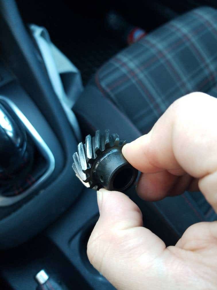

While we're at it, let me nose in here - new cam, new disty in my new setup, normal break-in wear?
