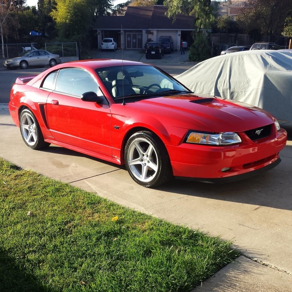

17x10 w/ 325/45-17 M&H DR's.
I had the rear narrowed 1 1/8" (?) per side but it was too much even tho the tire was perfectly centered in the wheel well so I added a spacer to space them back out. I think a 94-98 rear would be perfect as-is.
That looks pretty badass. Always liked thicker sidewalls, I hate the rubber bands I see ppl running around with, my last car had a 26.7" rear tire via a 275/40/18 BFG and that really filled up the wheel well nicely and hooked great. Hard to pass up the price of a 315/35/17 MT Street Comp tho...
