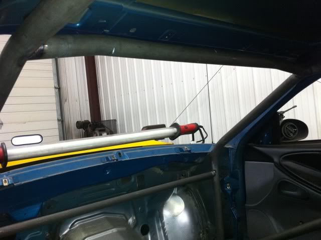

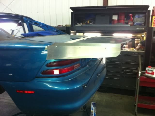

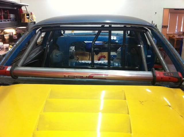

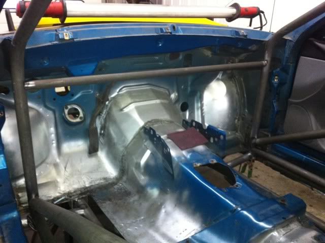

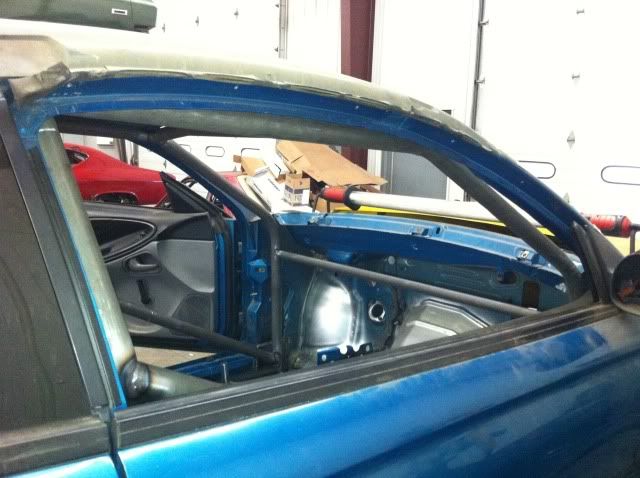

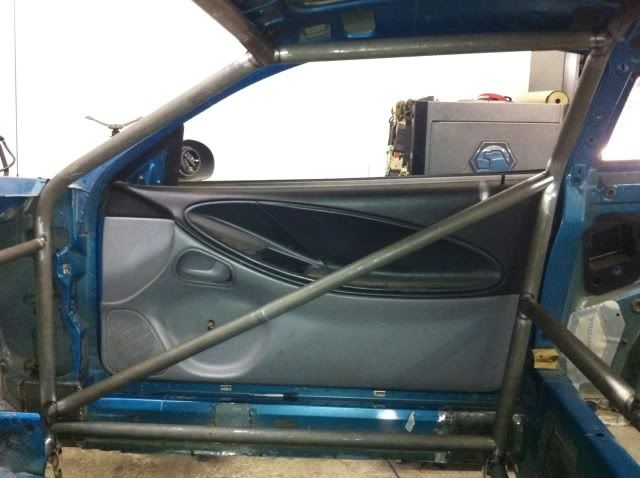

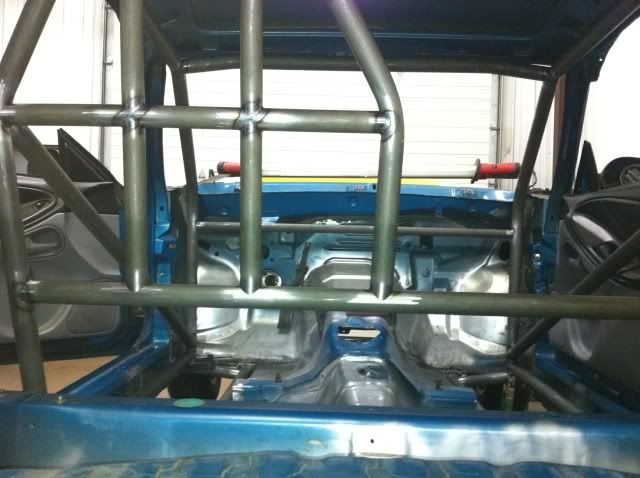

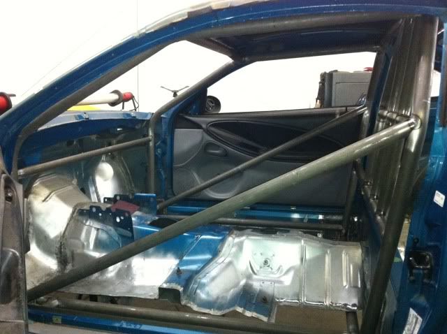

My Ultra Street 25.5 sn95 build
Well cars been in the chassis shop for a few months now and finally making progress so figured id post up a few pics of the build. Car is a 94 mustang with all team z suspension in the front with strange struts and the rear suspension is from trz using team z indexing lower controll arm mounts and afco double adj coil overs. DC Performance in bel air maryland is the shop doing the car. Plans for the car are to run 8.50 index with it but may run a yr in 10.0 depending on whats in the budget for this yr.
