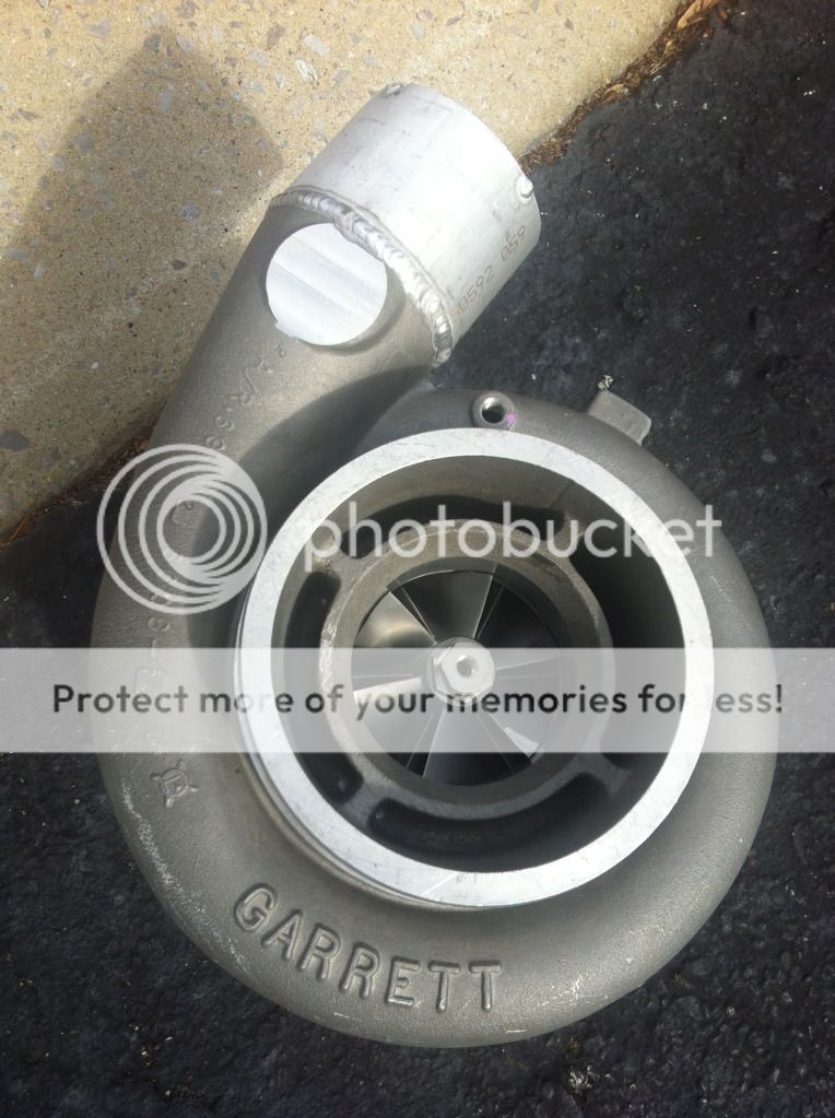

The turbo on the right is not a real Garrett gt4508R. Doesn't even look the same. Show a pic of your supposed 88mm GT45. Show me the Honeywell number plates
this is a real GT4508R..The v band was cut off to use hose couplers. I know a bad idea...
Oh and that 88mm you supposedly have? VS racing sells them for $599. That is a chinese knockoff turbo. Its not even in the same BALLPARK as an 88mm garrett GT series turbo.
In the op it says gt45, nothing about Chinese. When somebody tells me they have a gt45 I assume we're talking about authentic stuff here. If a Chinese turbo is labeled gt45 it's not a real gt45 and shouldn't be referred to as such. The real gt4508r turbos are much bigger, more reliable, quicker spooling and make more power. You show a real gt4202 in the picture on the left but your comparing it to that eBay gt45 should give you an idea about the size difference of real Garrett stuff. There's a reason they cost $2700
