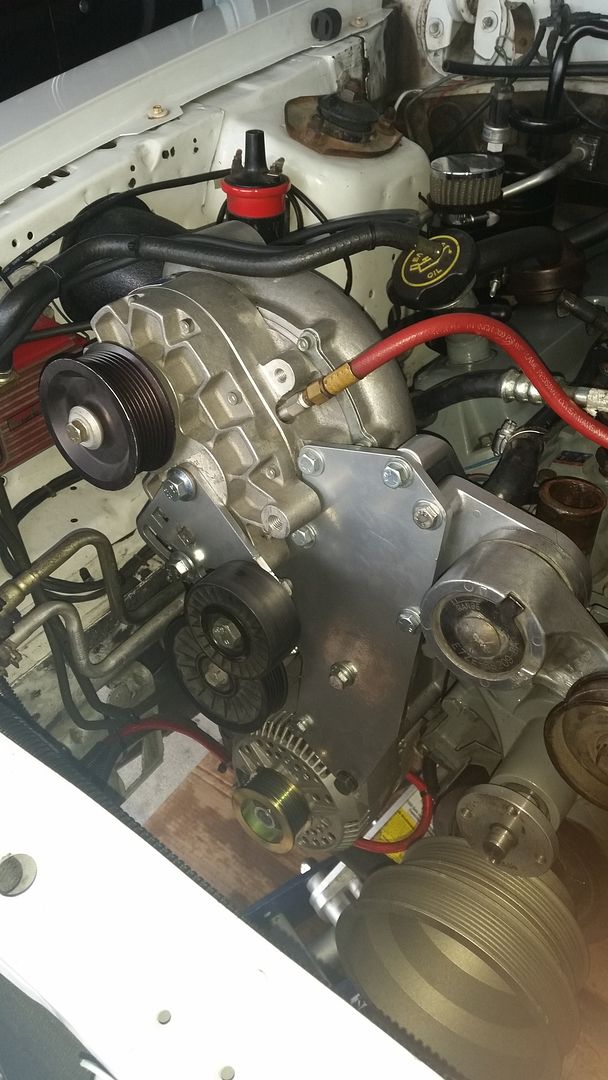

I have a V1 S trim right now. I have a 6.87 crank pulley and a 3.33 blower pulley. Talking to other people the S trim is small for what I’m trying to do. Is there anyway I can get this S trim to pump me out enough boost to get me to 600rwhp. I am willing to purchase a 8” crank pulley. I would also like to tell you that I have a BOV valve in my current discharge tube. I also do not have an intercooler.

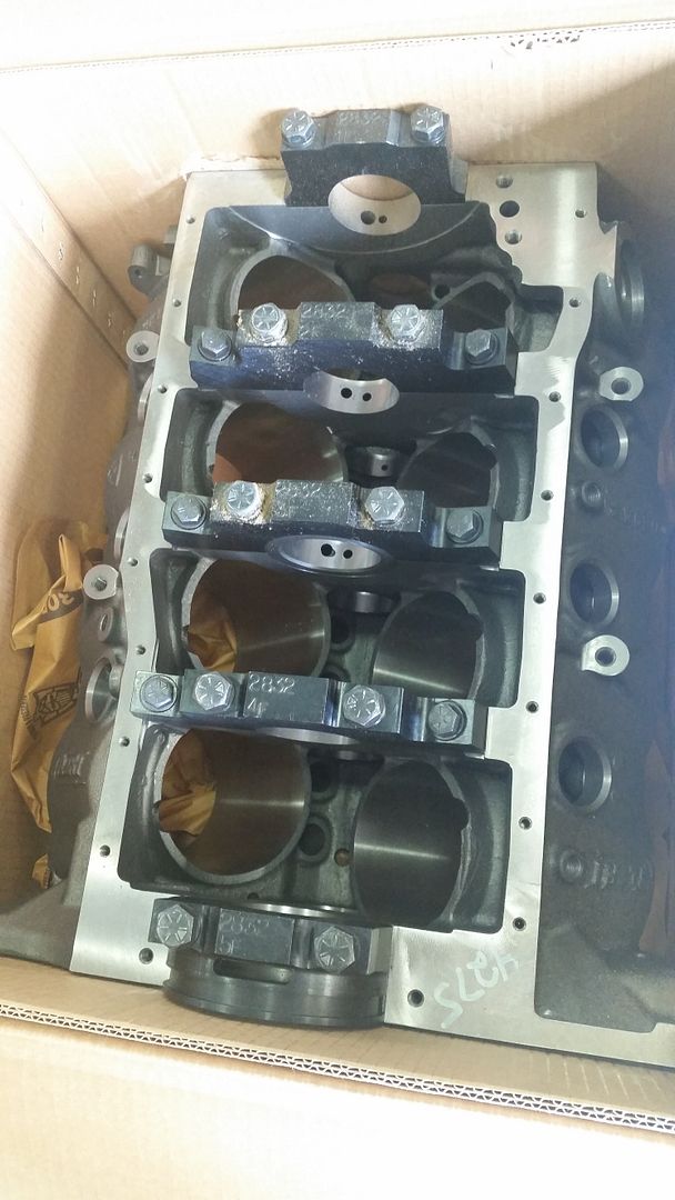

My 4.125 Bore Dart block

I say..Better to slow down & talk to a Pro(or three)who does this all the time? Pick their brain & let them pick your parts,even if you have to pay them. Most of us GUESS at what parts will work together,then get disappointed(myself included in that)..then have to buy more parts..more frustration! As far as the S-trim,it'll do what you're wanting..but leave little/no room for growth. There are tons of EFI tuning options nowadays..and frankly,unless you are very computer savvy..along with knowing how to tune a blown, EFI motor..I'd say most are a PITA! I don't normally endorse products...but having seen 2 cars built recently with a Holley Dominator EFI system,I say to save your money & go with the Holley system(since you are starting from scratch). It makes tuning EASY,and self learns..plus has TONS of other capabilities:cool:. If you decide to just go N/A...I think you are probably going to end up around 500rwhp. I say that because you stated that you want a trouble free,jump in & go,fun street car. To go past that will likely take lots of cam,compression,E85,and steep gears to turn lots of RPM's(not sounding like what you want,IMO).If you did decide to stay N/A...a carbureted set up will be easier,and cheaper..just gets less mpg. Read all you can about Shifter & Slo5oh's cars..they run good & are well sorted 363's:salute:

I have a R331ci stroker that had a S-trim HD race blower running 18lbs and put down 680rwhp on C16 and a Lentech 3 speed, Vic Jr 220cc ported race heads, extrude honed and race ported Saleen intake and 11.5:1 Ross dome pistons. tuned on a stock computer. was in my 88 coupe drag car.
decided to swap race engines and put the R356ci stroker with Vic Glidden 300cc race heads and GRP aluminum rods in the 88 drag coupe with the YSi blower.
The R331 came out and is going 4.125 bore with CP 2618 forged dish pistons. same Vic Jr heads that have been gone thru and ported again and refreshed. using the same intake, have RCI big tube headers 1 7/8' with 3 1/2" collector with marman clamps, mcleod twin disc and a T56. using the same S-tim from the drag car pullied for 15lbs and this will allow me run pump gas on the street. all goin in the 89 road race coupe. only looking for 600-650rwhp.
u will need around $2k just for ur fuel system to feed ur beast. then suspension mods, like welded battle boxes, 31 spline axles, auburn pro posi, etc.
I run heavily ported AFR 205's that flow 330/240cfm @ .600 lift on my 11:1 CR NA 347.
IMO, I would go to the AFR 220cc head or the TFS HP 225cc head for a blown 363. I would also go to a Scat 4340 H-beam rod with ARP 2000 rod bolts, and use ARP head and main studs. I would choose Diamond or CP 2618 pistons with tool steel wrist pins, rotator neutral balanced. Nothing wrong with weisco, I just like buying top shelf race stuff. Make sure the intake manifold flows more cfm than the heads and run the s-trim at 15lbs.Look at the Vic EFi and super vic.
