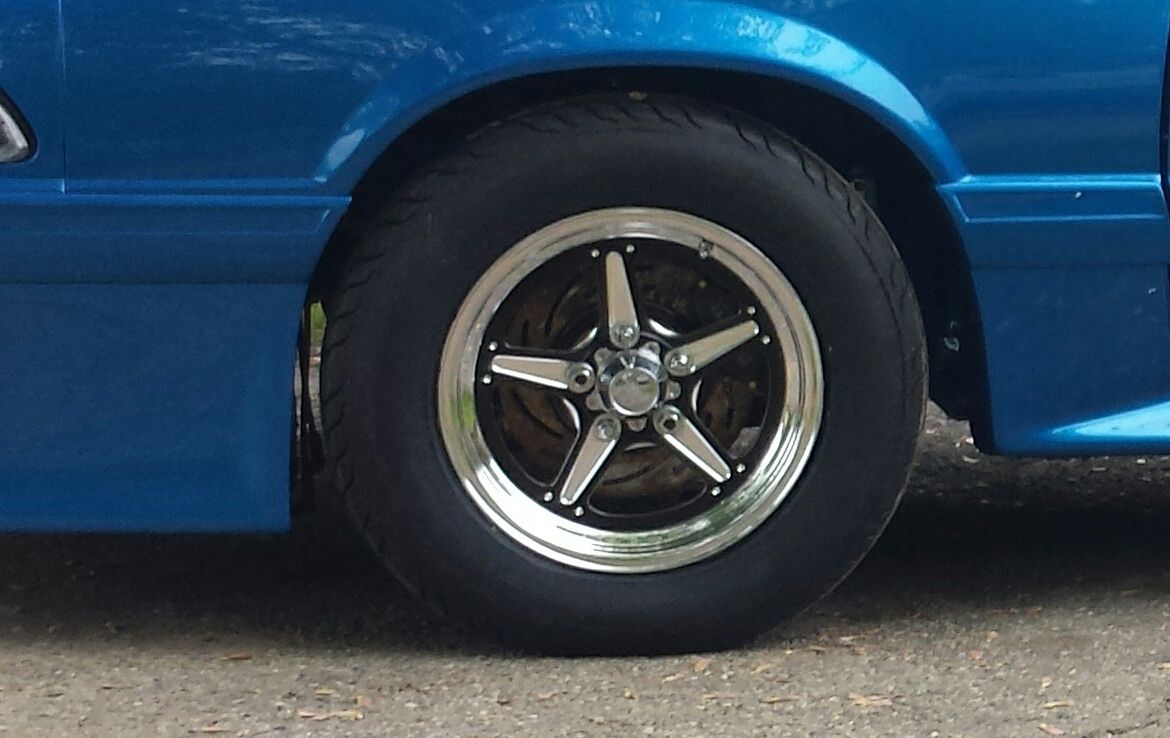

Just some old Rodlites. But have RTS on the way.

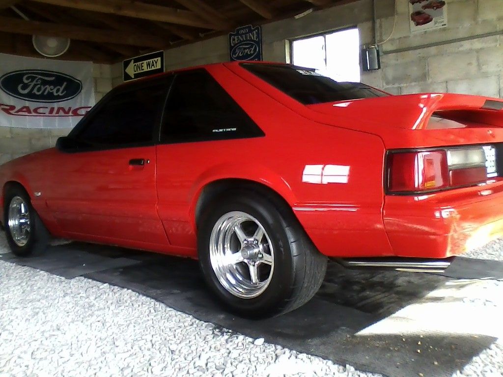

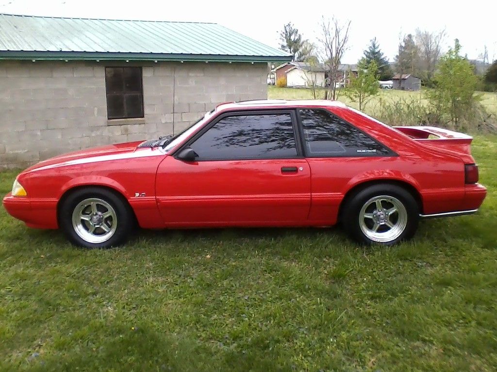

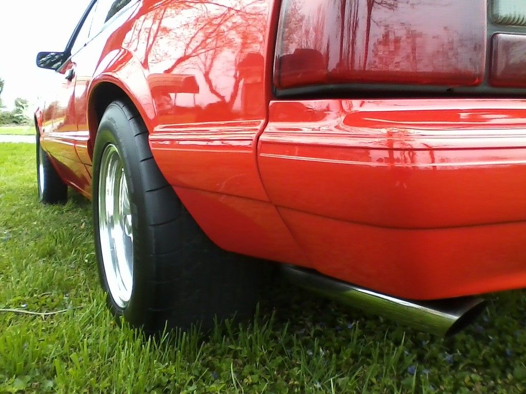

My 88 Notch with 17x4 and 15x10 SVE Drag wheels, I was worried about the 6.25 BS but they fit great, I did roll rear lips and used a hammer to beat in rear inners, The ET streets 28x11.50 wanted to still rub on inside when car leaned hard. So I went with 1/4 spacers and racing studs. With a lil smaller tire I wouldn't have had to do that. My Front brakes are SN95 and rear is still stock with Drums
