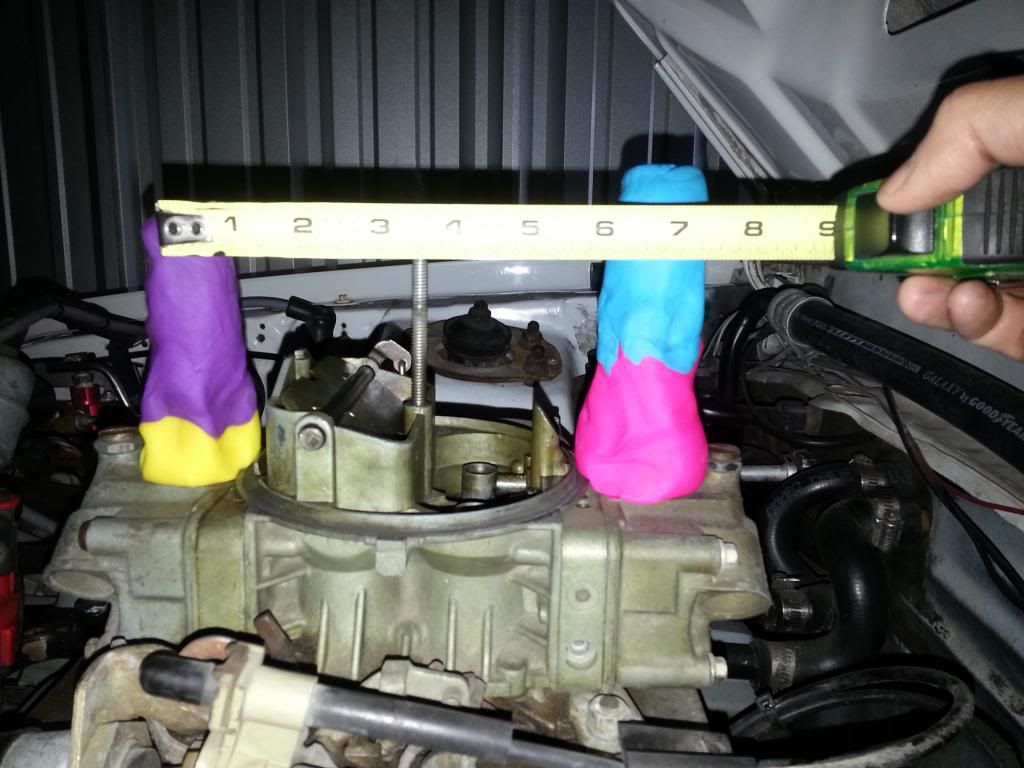

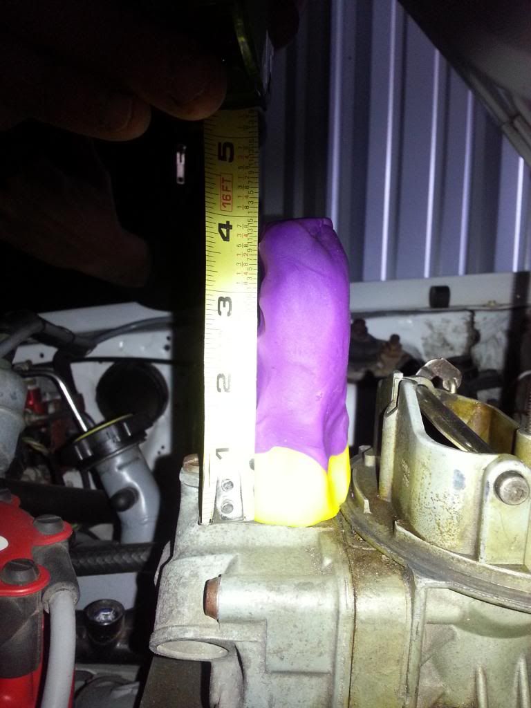

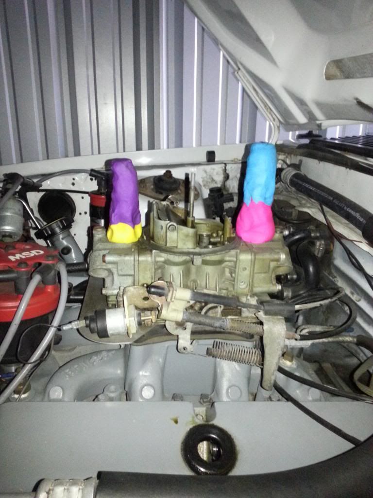

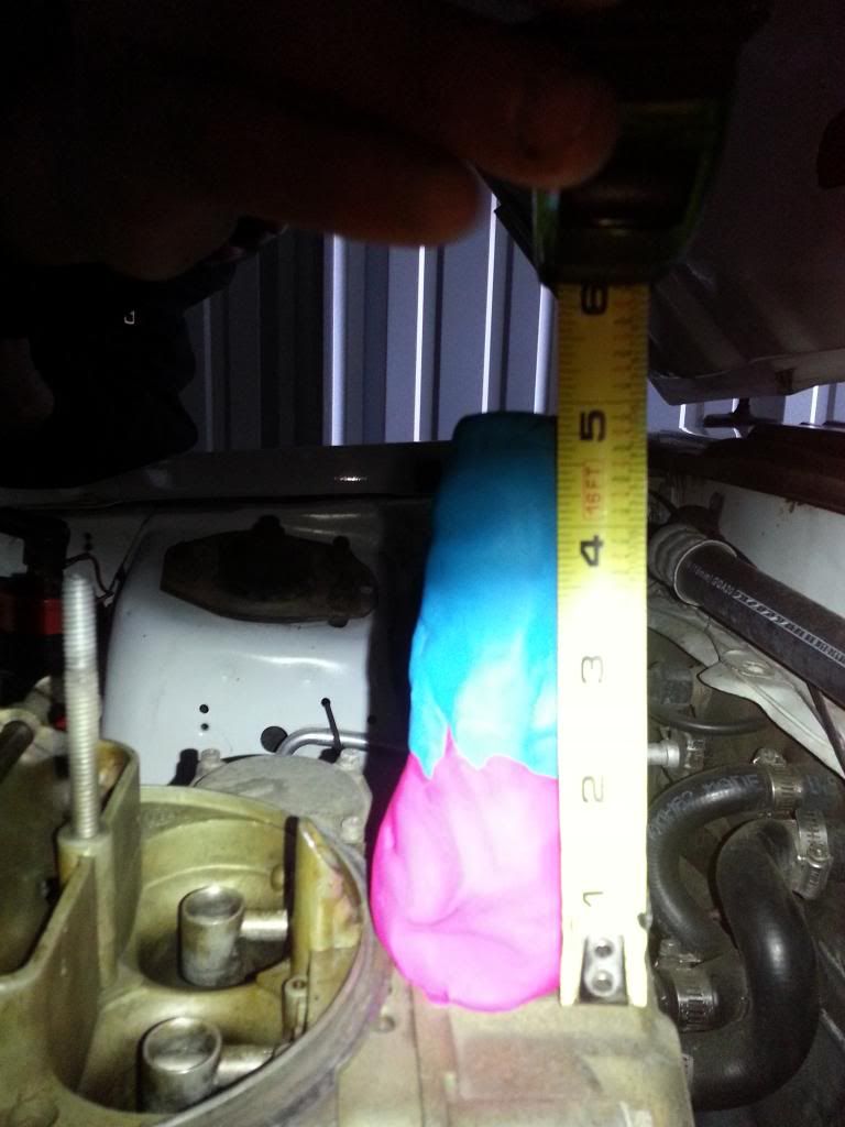

Last night i took these measurements. What do you guys think. Enough room?

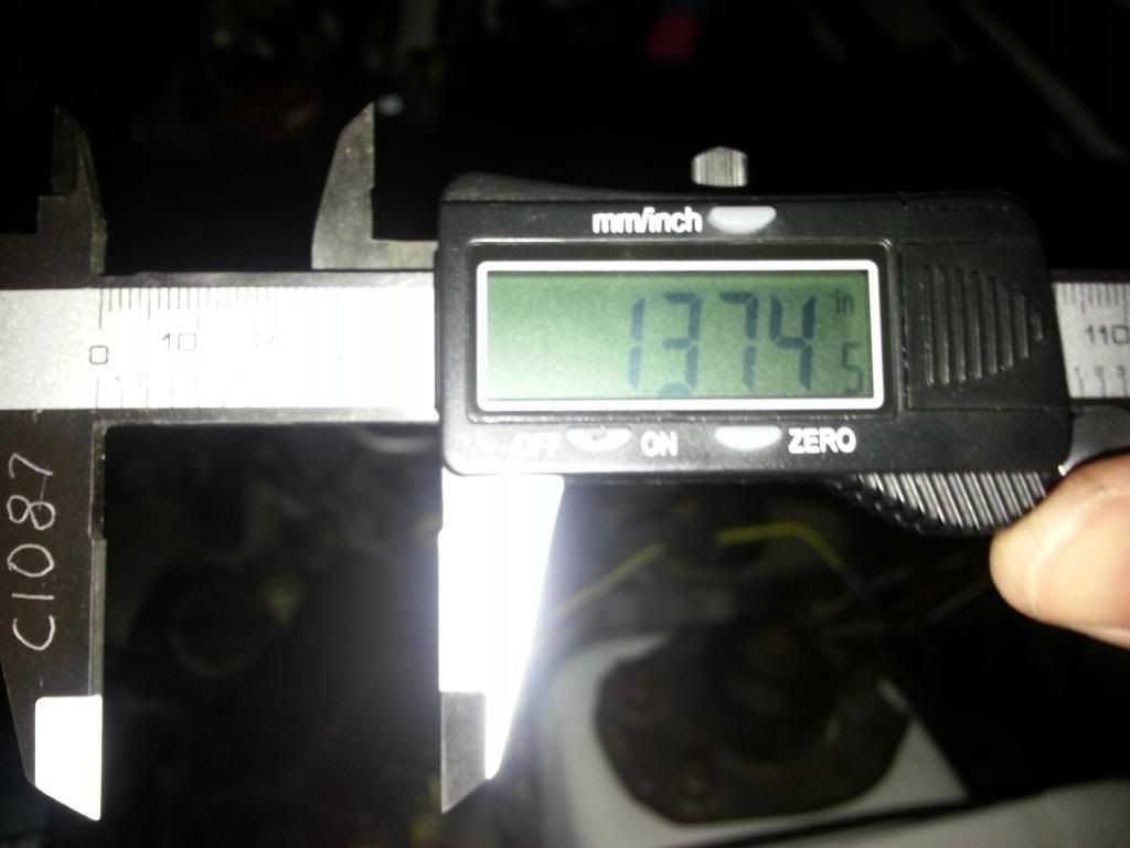

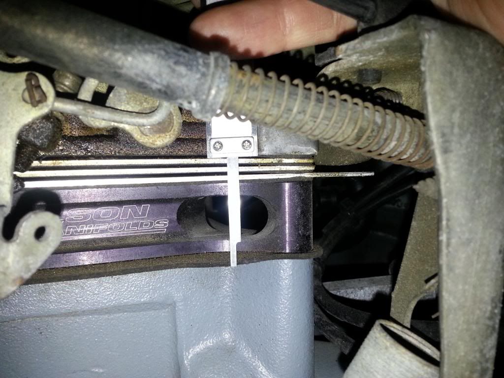

**NOTE** that i do have a heat shield and wilson spacer that are under my current carb. The spacer plus gaskets and heat shield equal 1.375" those will be removed as I will no longer need all that with the blow thru set up. So add that amount to those measurements.
at the rear
at the front
Distance between the two
at the rear
at the front
