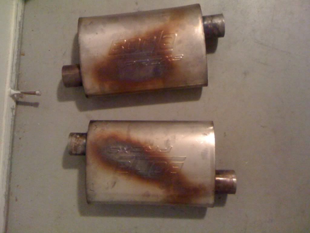

My car has always been cursed with loud exhaust. It's just a mild 306, maybe 260 RWHP, with 1-5/8 equal-length shorties, magnaflow spun-metallic cats in a custom 2.5-inch H-pipe, and a 2.5-inch cat-back with full LX tailpipes. Everybody says Super Turbo's are almost too quiet. Mine were louder than hell, so I replaced them with new ones. They were quiet, for about 2 weeks, then got louder than hell again. So I replaced them with some Borla ProXS, because they're supposed to be quiet. They were...for a little while, then got louder than hell. And here's what they looked like when I took them off, after less than 4000 miles (350 of them on road courses):

The primary reason that mufflers get louder over time is that the packing material in them breaks down due to vibration and heat. WOT open track use is going to do this faster than anything on the planet, other than maybe dyno pulls.
You might try to lower the mufflers in the car some to get some airflow between them and the floorpan of the car. This might reduce the internal temperatures inside them some. Have you checked the temperature of the floorpan after a 20 minute session?

It's carpeted and still has a rear seat so it's hard to get a read on that, but the forward area of the trunk over the tailpipe uprights is practically too hot to touch

Wouldn't you benefit from mufflers that don't have any material in them ? Based on that heat-discoloration, you can assume that is where the exahust is crossing over from the inlet to outlet, and its blowing out any material or just straight up melting it.
I would think some flowmasters would be the way to go.
