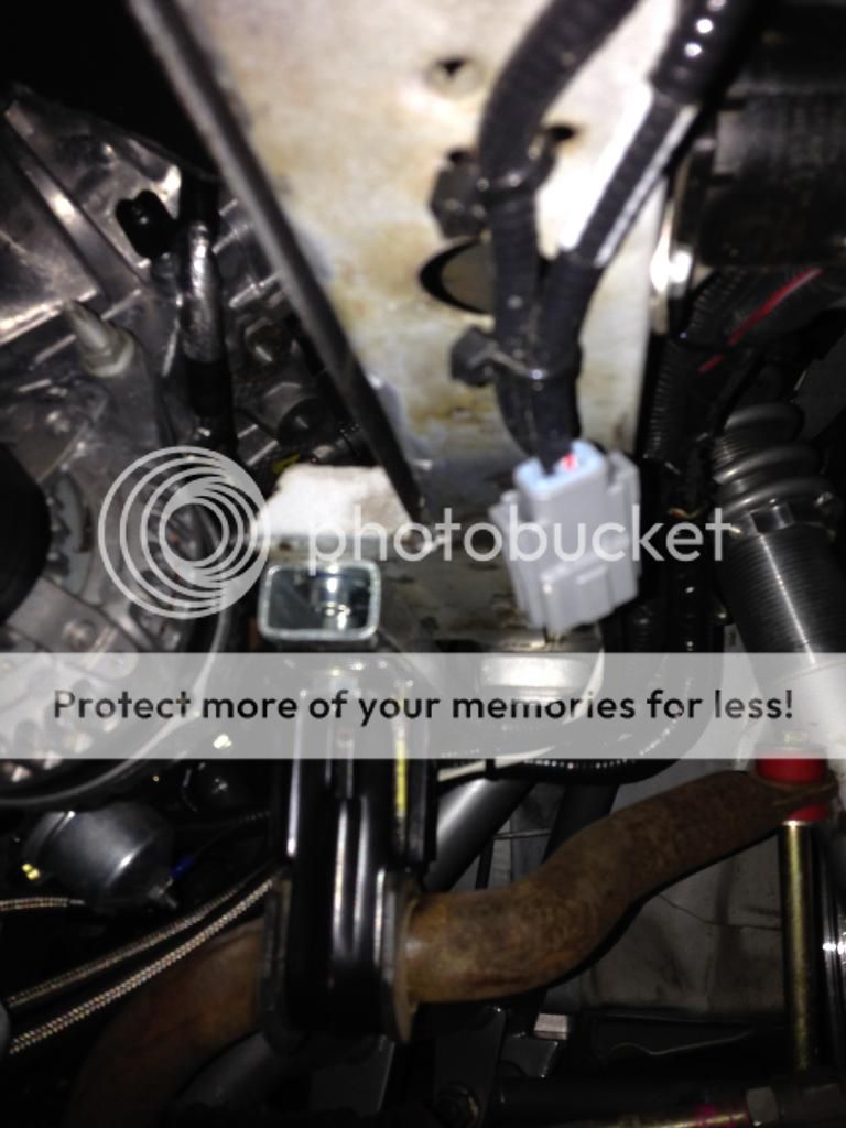

TKO has an OSS sensor port. I bought an oss sensor plugged it in and ran that to the Control pack. Are you sure the T56 doesn't have an OSS? I did a good write up of this in my build thread somewhere. Think I even had a link to the pics showing the difference with OSS and VSS. If you only have VSS you may need the converter that Ford Racing sells.
There is a pic of the filter and sway bar here (as well as some other eye candy): testimonials2
I did not relocate the mounts and the filter comes out just fine.
