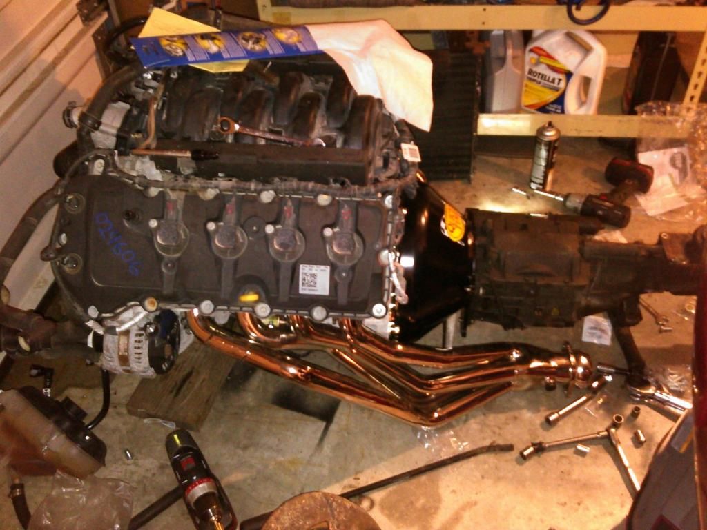

I picked up the motor this afternoon and started tearing off some stuff that I knew I wouldn't need. Let me tell you... that cast crap is heavy and the motor mounts are ridiculously heavy. I took the intake off just to clean it up a bit.
There's been a lot of talk about the intake... looks identical to the GT intake if you ask me. It doesn't have the gromets in the top to attach the 5.0 cover but it does have the holes for the gromets. Since I can't run a cover on my Factory Stock car I pulled the gromets from there and put them on the F-150 motor. The F150 heater hoses may cause some interference with running the cover. I also swapped the fuel rail insulators between the two.
As mentioned by others... the timing cover is a little different on the F150. This motor is from a 2011 so don't know if there are changes between the years. It doesn't have the hole tapped for the pulley just to the right of the water pump. From pictures I've seen online, it doesn't need it. I'll just have to figure out the right length belt since the Boss alternator belt is a touch too long. The bolts from the Boss alternator kit fit the F150 alternator so I'll have to size them and get some duplicates.

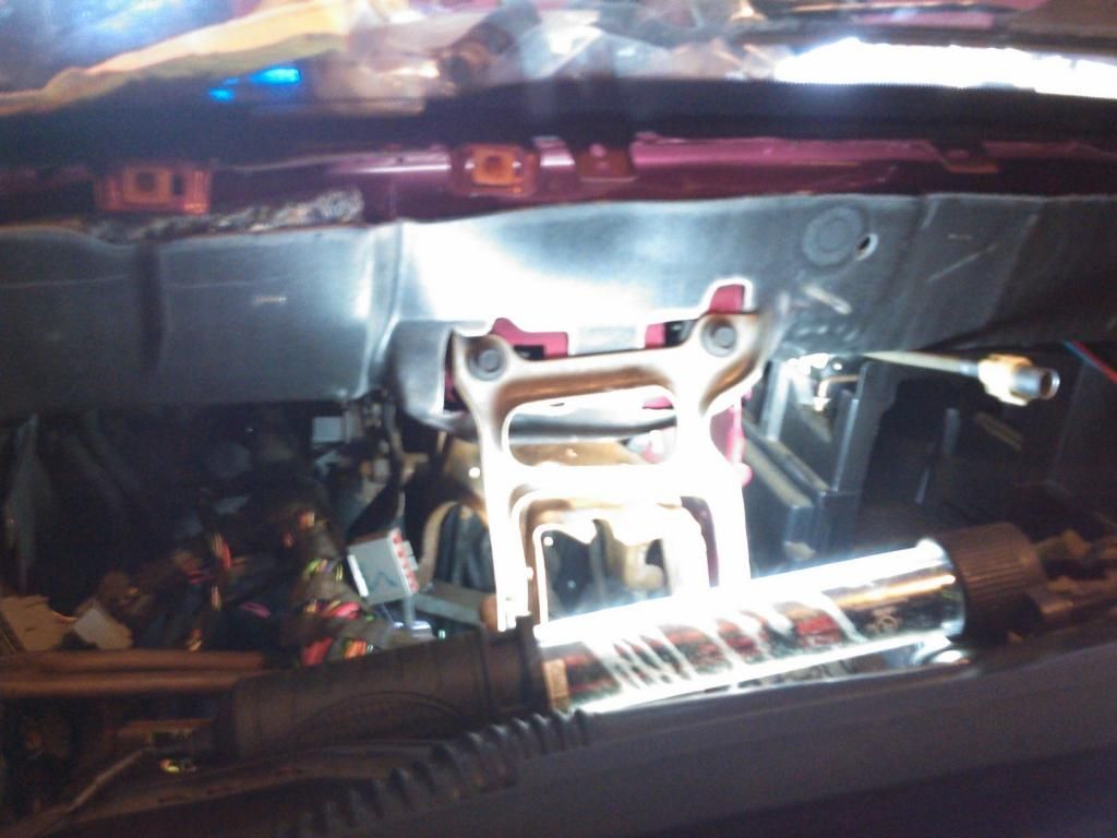

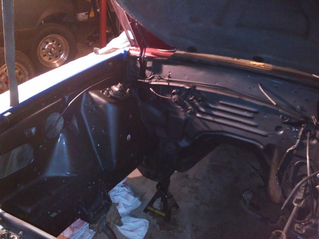

Right now, #4 is ahead of schedule. I got the old 2.3/trans out, pulled the computer/wiring and dropped the stock K-member. Today, I picked up a set of V-8 spindles and unexpectedly scored a UPR conversion k member and motor mounts locally. Now I want to push to get the bay cleaned up, order the headers and control pack. I thought I had a trans locked in but the guy sold it out from under me.

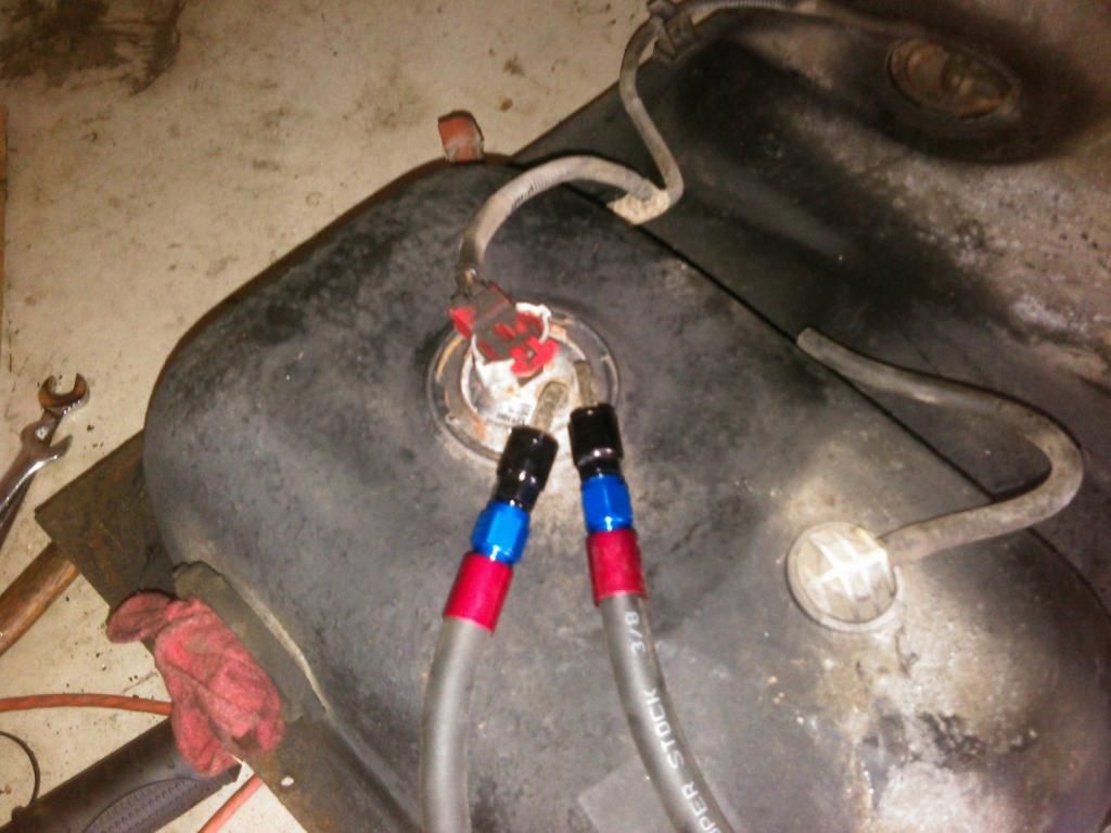

Got a chance to finish the back half of the fuel system

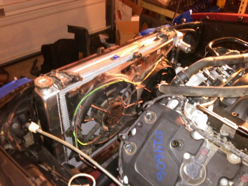

Finally figured out what I wanted to do with the cooling system. Experimenting with a Summit radiator and Contour fans.

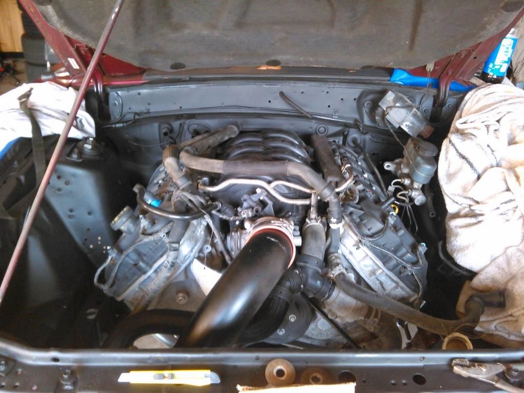

Some of the control pack electrical is wired up. Really just need to get the battery relocation stuff so I can fire this beast up. Then it's on to the brakes...
