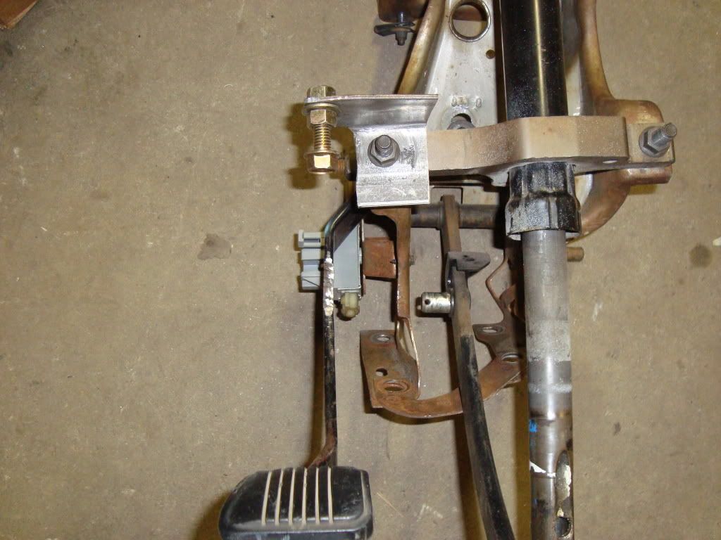

#39 ·
Here is a pic of a top side clutch stop that I have in my cars. Bottom is nothing more then a 5/8 bolt that has a nut on the inside of the car and the outside. Very simple and easy to do.
#40 ·
pull your clutch pedal off, burn a nut to it and you will have an adjustable stop for any length bolt you choose ... i bought 2 different length bolts just to see what worked the best, then get a nut to lock it down ... shannon burned this on and painted it in about 3 minutes ...
just watch the angle at where you burn it on, you want that bolt head hitting flush on the carpet ...
