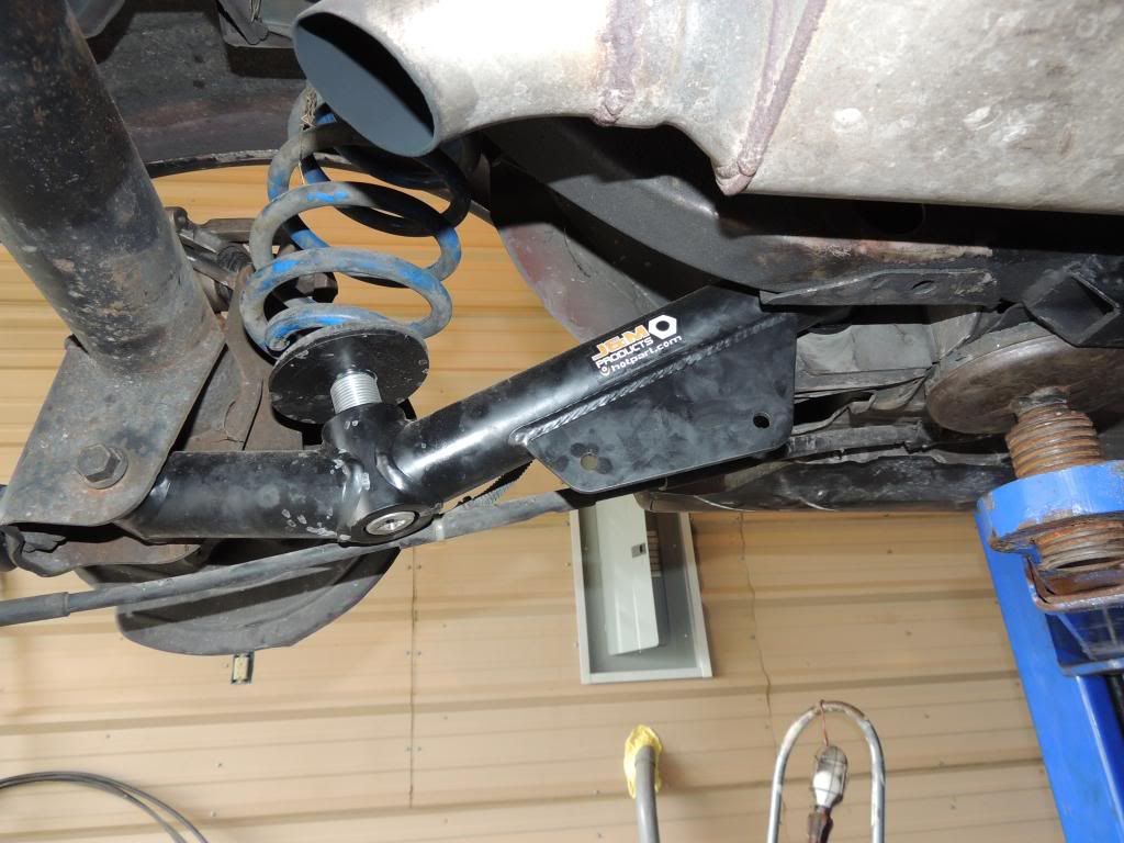

I already ran with a recommendation from Maximum Motorsports and bought the Bilsteins and MM non adjustable RLCA's (no problem with existing ride height)...along with other recommended parts/bushings. I suspect these additions will be good enough for this driver, on these roads, with these tires and brakes.
#15 ·
Thought I'd add that the Bilsteins did eliminate any road-dip created tire rub I had in the past. Sensa tracs just didn't dampen the movement enough.

Should have got the adjustable LCA's. You might not think you need them now, but at some point you'll wish you just spent the extra $$ and bought them from the beginning.
That may be...but really I call it an improvement over the flexi-flyer version of the car a few years ago. Had it in my mind that any raise in the rear would equate to some drop in the front. Gonna give it some time, now. Been a busy winter working on the car....
