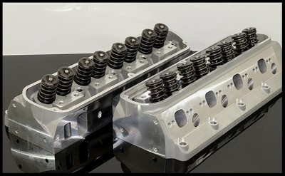

I was going to put a set of P heads on my 88 GT use only on the street as a cruiser but the deal fell through on them. I am now looking for a set of heads. I have been doing a bit of reading on the cheaper aluminum heads but just didn't come to any conclusions if they were good to purchase or not.
Looked at these 3
I will be running a stock 302 block, explorer intake, stock cam with 1.7's, full exhaust, 5spd.
Any advice on head purchase would be great, are the 190cc heads to large for a stock bottom end? If anyone is selling a nice set of used heads please message me also.

From what I understand the promaxx are decent. I’d like to see what the new as cast Afr heads are like, assuming anybody ever gets their hands on some.

All I can comment on is my current situation with the flotek heads. This last spring I had an issue with the stock heads being warped. I was in the process of building a new motor for the car but needed it to be on the road as I planned on doing power tour etc so was in a bind. So I went with the flotek heads to put on a stock 302. This was a flat tappet motor with a carb. The flotek heads are only good to like .500 lift out of the box and the stock cam is way under that. I purchased them and they worked well, I didnt have any issues the entire year and put about 2500 miles on the car with them.
I was pleasantly surprised with the cost of them but I will say they arent going to make power like the other good heads out there. And would need Springs upgraded for a roller cam motor. They did give my car a little pep over factory heads and it ran about 5 degrees cooler as well, but it wasnt a Huge noticeable different in performance.
with that being said I also would sell these heads as I wont be using them on the new motor. I have some stamped stud mount roller rockers, pushrods etc for them that would go along with if youre interested.

AFR165's right out of the box bolted to a refreshed stock block, stock cam 5.0 gained a 100 horsepower. Afr's or twisted wedge heads are the only way to go. Cheaper heads need guide work and sometimes a valve job before you can use them. Edelbrock e heads are good to but are priced close the the afr's. Remember, cheaper really means that you will have to pay more later later

I bought the floteks for the fact they were cheapest amd I didnt find a whole lot of negatives about them. I took the chance and spent I believe like $750 with a discount code they had. Its also good to note the Edelbrock e street stuff is the same type of head, china casting and valvesprings only good for lower lift cams or flat tappet.

Head, cam, intake. No, 180cc isn’t too big - not even close.
Look at ls engines, they have 4.8L engines that came with 200cc cylinder heads. The whole thinking you need a small port to make low end torque is BS.

Thanks for all of your suggestions, I looked into the AFR renegade series and that may be the way to go. Just a little over $1000 for both heads assembled sounds ok to me.

You linked to the Enforcer heads but called them the Renegade series. Two different animals.
