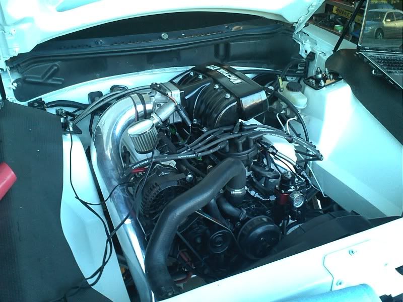

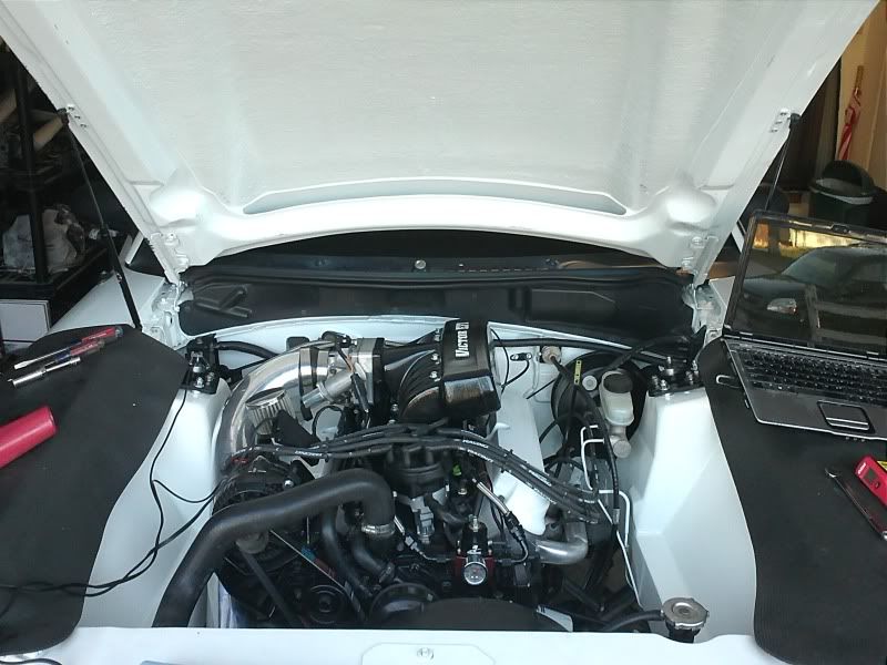

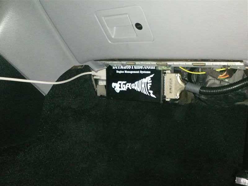

so after a couple weeks of reading, debating, researching.. i decided on a megasquirt PNP for my 95 mustang. almost went with quarterhorse at first, didn't like it with my plans for boost. considered running a pms again, but it's outdated and didn't do everything i wanted.
so i wrapped up my h/c/i install, hooked up the megasquirt, tied in the lc-1 and fired it up. i had to pull a TON of fuel out because of my 42lb injectors. but once i got that down, it idled. i confirmed the timing (have a slight issue with that), modified the fuel table to get it close, unplugged the iac for now and hit autotune. bam.... within a min it had a nice 14.2:1 idle, fans turned on as programmed and revs cleaner and cleaner everytime i hit the throttle.
i couldn't be happier right now. the reading paid off thanks to you guys, the megamanual, and a couple intuative videos on youtube. i have a slight valve tick which i attribute to a loose adjustment. so gotta fix that, adjust my bumpsteer setting and get this thing on the ground.
