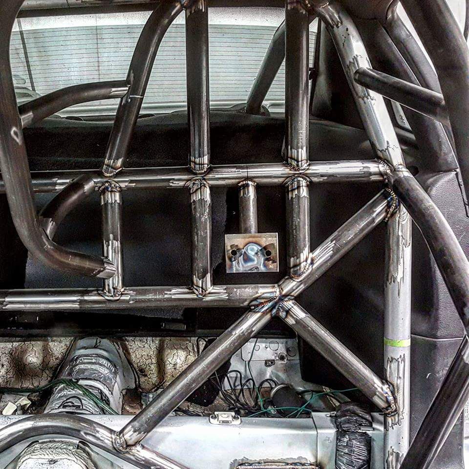

I like the main hoop. looks about as tucked as physically possible. lol
Its tucked and tight as possible. Even more so then it looks cuz its only held in place with a jack and a scrap wood. Lol. Itll be tight enough to hold paper when it gets lifted to its final resting place.

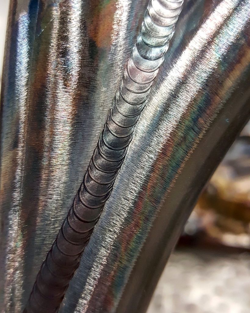

Finished up the lower rear control arms and sent them and the anti roll bar off to powder coat for clear. Turned out pretty trick!
Bead spacing got a little wild on the cover pass but sure looks nice!

Got the floor bars back under the car and the main hoop trimmed to fit. Nice and tight. Put some businesses cards in there to show it's nice and snug. Lol
Next up was the a-pillar and dash bars. Used the tubing roller to match the interior shape better then just bending alone. This is the dash bar.
Tough to see bit the dash bar fits nicely.
A pillar bars rolled and bent. Nice and tight!
Zero gap.
