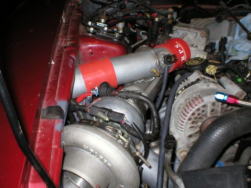

the wastegate can't have a vacuum(sp) source,(I guess it is still vacuum, just can't be after the TB) it will tear the diaphragm (according to tial). This is my wastegate setup
that hose is from the WG and connects to the brass piece. My bov line is going to my fpr if I recall.
