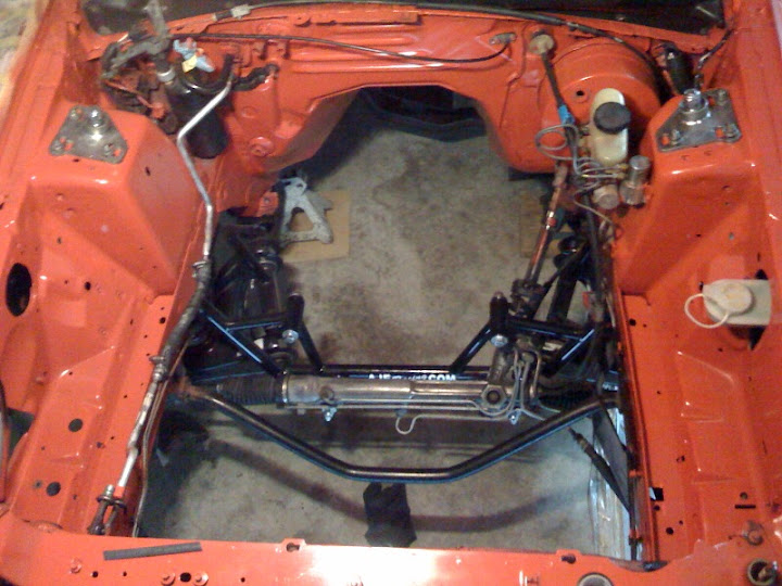

Anyhow, a few weeks back I pull it all apart and start the build. I knew the engine bay needed some TLC but I didn't want to get into filling the engine bay holes and all that (been there .. Done that... fork doing all that labor ever again).
So I started running all the wiring into the inner fenders,
Sanded the bay down and a fresh coat of paint
Installed new suspension components
Installed the subframes and welded every seem I could get to under the car (also burnt up the carpet ... :curses: ... war casualty)
