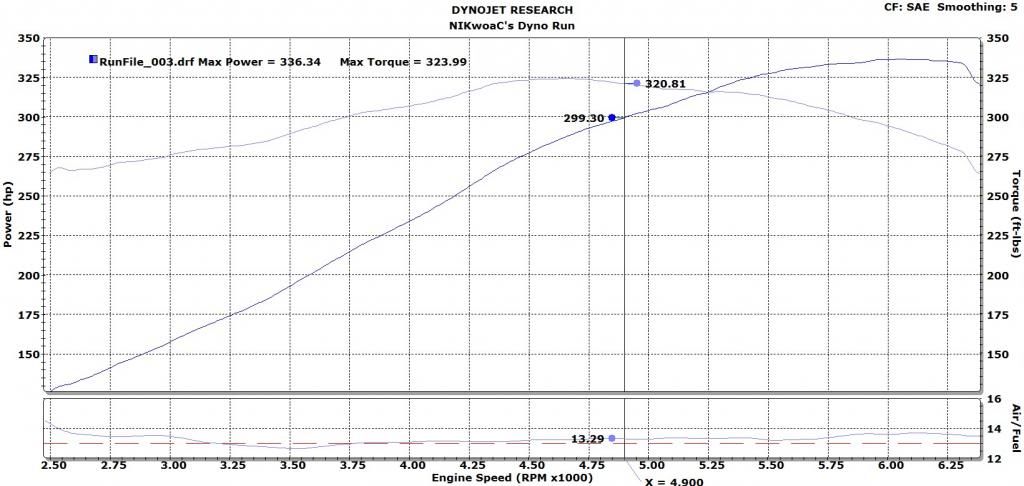

Stock 100K mile ’86 flattop short block with an OTS re-ring/bearing kit (with way too much ring end gap haha).
TEA-Prepped TW 205s, with 61cc chambers and something like 9.8:1 CR.
Comp catalog lobes: I/E 215/[email protected], .568”/.566” w/1.6 rocker, 112 LSA, straight up
TFS-R long runner intake, CNC port matched to the heads by TEA
90MM TB, 97mm Abaco MAF meter
BBK shorties and dronemaster 2.5” full exhaust
Tuned with a Quarterhorse with BE/EA by yours truly
336/324 SAE, Dynojet
I’m curious to know what correction factors some of you guys are using. My STD numbers put me in the 340s…
It appears most here are SAE, but it is still hard to compare dyno numbers from one dyno to the next, so don't get too caught up over differences as small as we see here.
