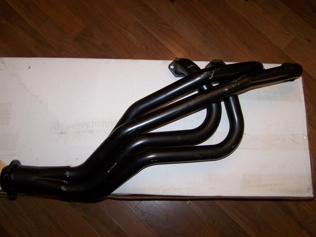

Can you do me a favor and post a picture of the passenger side header? I would like to compare it to mine.
I'll get you a pic later today along with a height measurement from flange to collector.
Here is the pic. I get about 12 1/4 inches drop from the flange to the top of the collector (meaning the 2 bolt flange). Hope this helps.

TF 2016. Just a thought here, would it help if the collector flange was turned 90* and then reattached? I would figure the flange is what you're having the clearance problem with due to that being the highest point there. How much drop do you measure?
Hmmm... my pass side one looks totally different! What part number are those?
This is what mine looks like -
Did you get a drop measurement? Are yours 1 3/4? Mine are 1 5/8 which may make for different routing of the primaries than yours.
