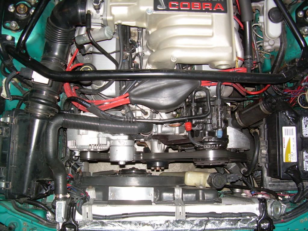

To provide ignition-switched power to the VSC, I tied into the power line for the Coolant Level Sensor, which you can see on the right of this photo. I tied the fan's ground to a ground bolt next to the battery, and tied the fan's positive line to the positive battery post.
The fan's wiring is Solid Black, Black w/Green Stripe, and Tan. The solid black is neg/ground and the Black/green is the high-speed wire which I'm using with this install. Tan low-speed wire left unattached.
I took the time to use corrugated plastic loom to protect the wires and provide a clean factory look.
What you can't see is the tie to the A/C feed wire because it's hidden behind the power steering reservoir. You also can't see the supplied temperature probe but it's just below and beside the upper rad inlet.
So here it is all mounted and wired. I used a piece of sheet aluminum I had laying around to make a block-off plate for the big notch in the shroud, and I purposely mounted the unit as far to the passenger side as possible, so I could have the most possible area of the radiator unshrouded. This aids with high-speed airflow and cooling. Doing this required trimming the shroud to clear the end tank on the radiator, which I insulated against wear with some foam insulation, but I don't have pics of those mods, sorry.

It looks like a great success. So far, the car appears to cool down with the A/C on instead of heating up. I'm sure it freed up a couple HP and it took a couple pounds off while cleaning up the engine bay.
Not counting the alternator upgrade, the fan upgrade cost me about $210 total for the fan, controller, wiring, fuse, insulation and looms, plus priceless little bits and pieces of fasteners and connectors I had sitting around.
