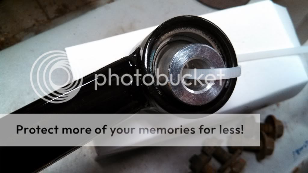

This is how my car sits. The rear springs are the stock sagging originals. My whole front suspension is all bearings, no rubber bushings anyplace. What's surprising is the car just rides so nice and smooth, just the opposite of what you would think. despite going with stiffer front springs, since there is no binding from rubber bushings, it rides softer then it did with stock springs
