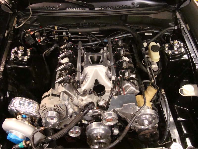

I got some work on mine while home but most of it was test fit trial run. Here is where I am at with it for now and will stay untouched till my next trip home (December???).
Nothing wired up just stabbed and resting in place to build around.
